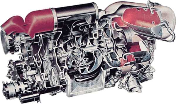

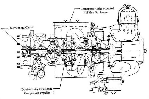

                    Re: Diferencias entre turbo a rulemanes y turbo a bujes.
                    1955
                    The turbine rotor and the compressor rotor are separate assemblies, each one suspended in two bearings (a ball and a roller bearing)
