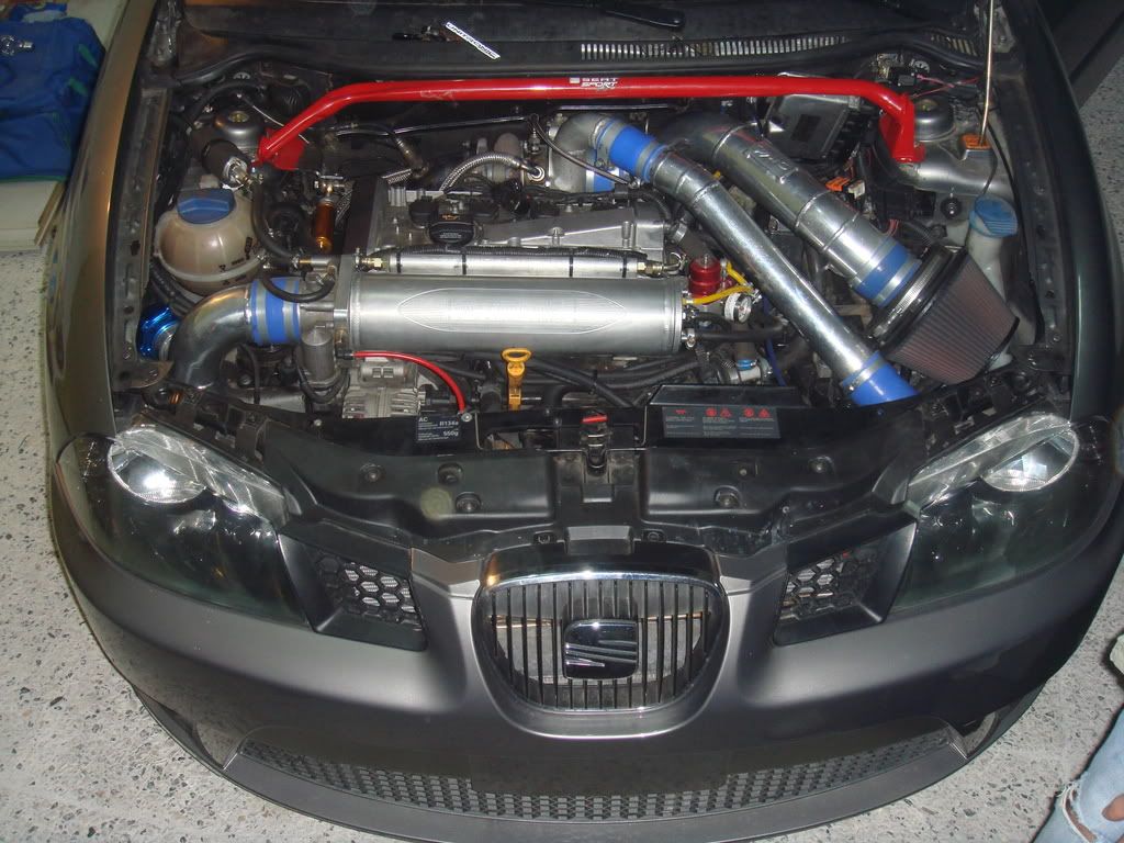

32 psi on 100 oct, 32°C-34°C ambient Dyno Temps
- GT3076R with HKS hotside 0.73 a/r
- Tubular equal lenght exhaust manifold
- Tial 50mm BOV
- Tial 44mm ex wg
- AEB head ported polished
- Inconel exhaust valves
- Ti retainers-spings
- 3652 cams
- Wiseco 81mm pistons
- Scat rods
- Balanced crank
- Clutchnet 6puck disk-red pp
- Vr6 lightend fw ,balanced
- 76mm turbo back exhaust decat
- Sard 280lt/hr intank pump
- Walbro 255lt/hr inline pump
- Aeromotive fpr
- Ross Machine intake manifold and fuel rail (Awaiting SEM Intake )
- Vr6 tb
- 870cc injectors @ 4bar fpr
- SAI delete,N249 delete,Maf delete
- Peloquins LSD
